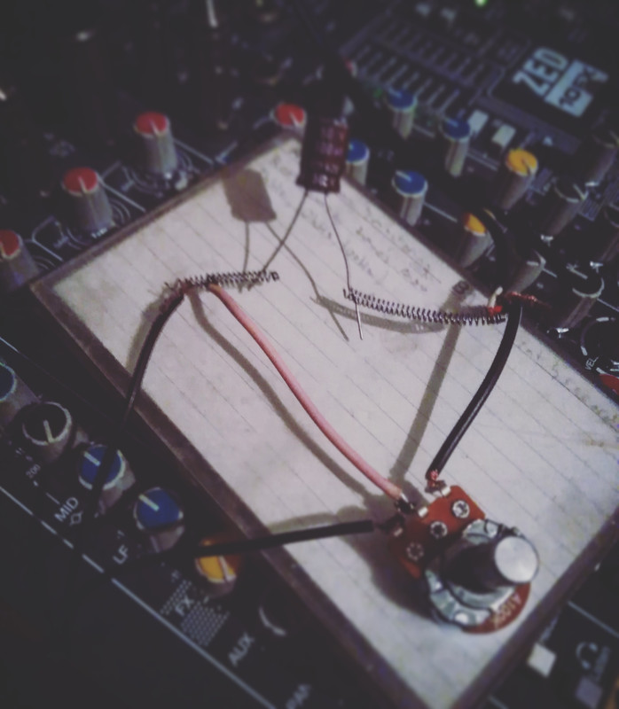

Here's some testing I was making earlier (it was originally for a synth)

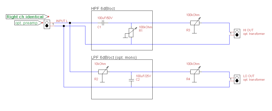

Here's the initial schematic for the crossover (ignore the component values, the prototype uses DIY caps)

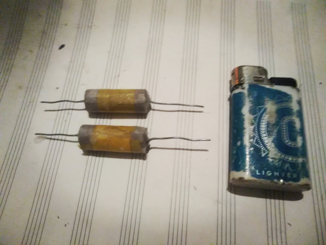

Some components (I have some off-the-shelf caps too but I'm afraid they're either too small or too big.. the protype uses a preamp)

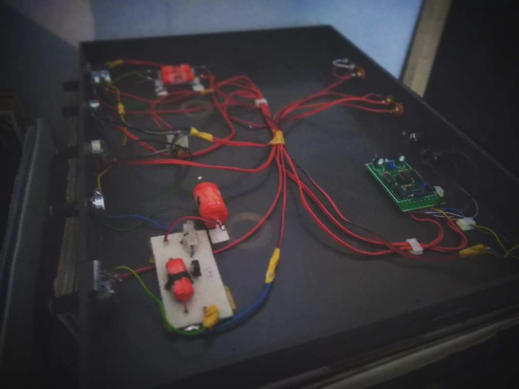

Here's the case with internals
And a close-up of one of the modules.. (edit : I might make a proper PCB if I get around to it.. cardboard isn't quite professional yet very retro)

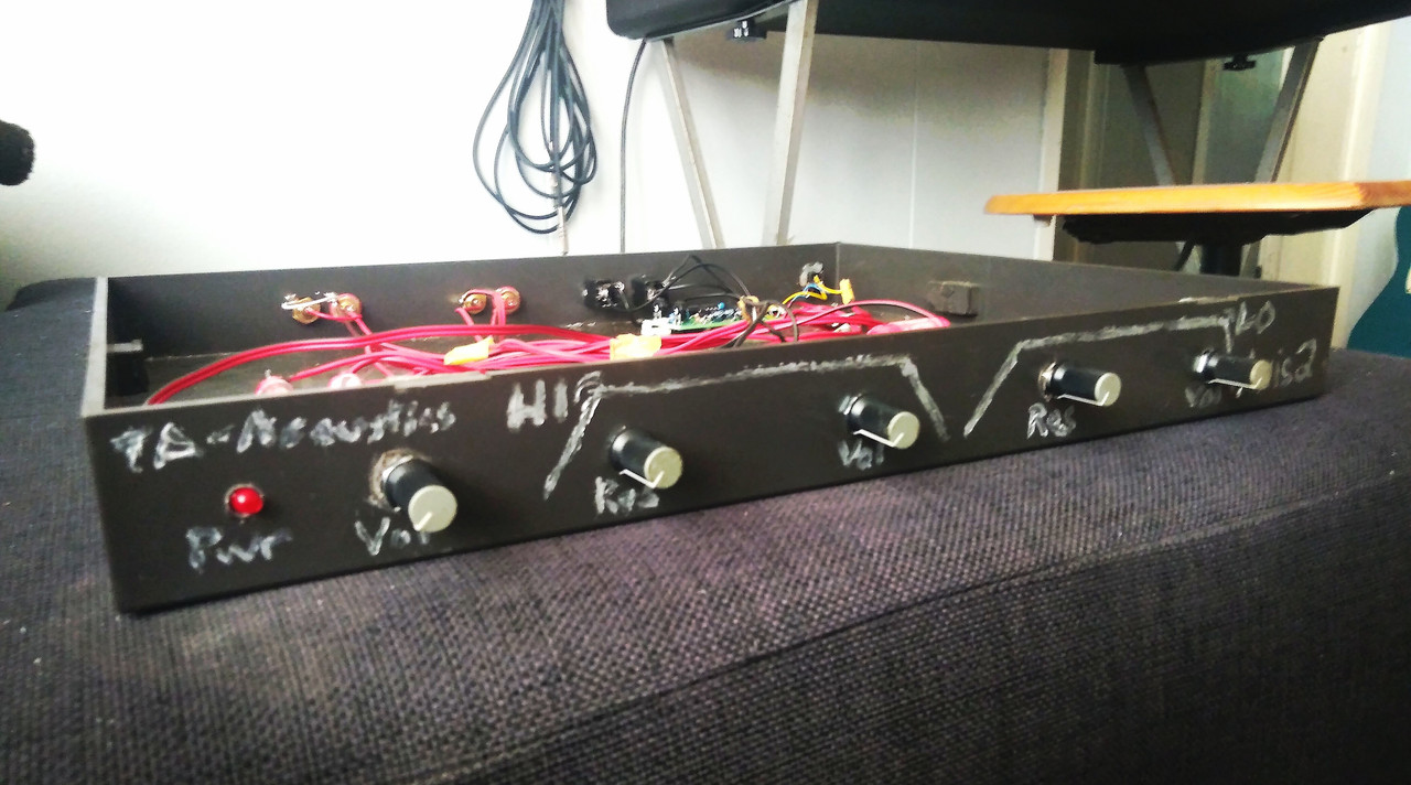

As of now it looks something like this :
Here's a front shot (I accidentally painted the freq curves the wrong way around) :
Now, I have a few questions... I don't have a cap tester, or amps to do passive tests with, as well as having a go at calculators for cap values which brings into mind a few questions... is it generally speaking better to use inductors? Or multiple smaller caps to get close to the exact values? The high band is a stereo 1st order and the low is a mono cascaded 2nd order filter (I have some modules to up the HPF 2nd order or put them in series with tweeters)
The idea isn't to tweak the xover every once in a while to match the input signal hot enough to keep it running.. I may try with some other caps (I've been looking at Amp Ohm, Audyn and Nichicon) as it's very quiet atm.

EDIT 2 : another question is whether it's a good idea to keep the 2nd and higher order filter resistor values the same with a single pot?
EDIT 3 : almost everything has been done so far by ear and intuition.. although I might make a calculation or two to make sure I'm on the right track every once in a while. Some of the modules have a nice thump to them.. others sound very gritty. My guess is that the caps last a year or so, because they're essentially tin foil, paper/cardboard, felt/fabric, stearine/parafin and oil. I made a few from aluminium and copper sulphate, sealed with hot glue.

Here's the revised schematic as I promised..
It's missing a few values because of the DIY caps and the potentiometer values may seem strange since I made it from stuff I found while going through boxes and drawers, ie. happened to have at hand..
I have some off-the-shelf 100uF/25V Lelon caps as well as 100nF ones and a few spare 100uF/50V Nichicons too but since it seems to work there's no reason to change them. The lows aren't as saturated as before after switching to the Nichicon in the LF 2nd pole (edit : could it be due to the individual pole cutoff bands not overlapping?)

You could try epoxy dipping your caps to prevent the foils oxidising .
I can see your making the most from what you can scavenge ,and the giant scrap heap generated by electronic waste is a treasure waiting to be found . I prefer reusing components to new anyday ,cause the resources of the earth are finite and war is the only option to extract new stuff.
Yes, but I think the oil and parafin does that to some extent too.

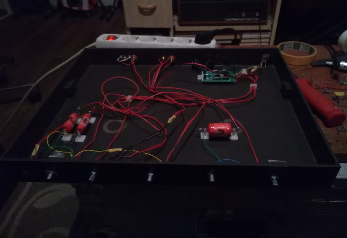

Here's a pic of the updated version with the compressor in the LF
EDIT : I was also thinking a clip LED for the comp/limiter
EDIT 2 : if anyone is interested I substituted R2 with a 10K trimmer, R4 with 4k7, C2 and C3 with 100uF/25V and VR1 with a 10K trimmer. Q1 is a IRF520 MOSFET. I've been doing tests with 12V and it didn't melt so I guess it's all good.
