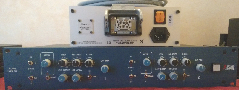

I've recently finished a two channel Helios based on Ian Thompson-Bells designs.
The noise floor is at -94 dBu (flat), measured with a Neutrik Minilyzer.
I've used an external PSU, to me the key to a low noise floor.

I LOVE that dc power connector! Even its style says vacuum tubes to me. Do you have the part number for it and its mating half?
Holger said:
The one you are using looks to be this one:
https://b2b.harting.com/files/download/PRD/PDF_TS/09330062701_100129971DRW005A.pdf
It says it is 6 way but you seem to have 6 connections plus the chassis. Is that right?

The guy who's testing my stuff for VDE compatibility measured the EQ today.
The noise floor is, measured with an AP One, at - 95 dBu.
The frequency response is almost the same as the RMAA measurement done earlier by me.
An excellent, awesome sounding EQ that is also a wonderful line amp.
The "Mode" switch switches a 10k pot and an additional tube to the circuit before the passive EQ. This was intended to add some "THD" mojo and works surprisingly well.
I named the equalizer "Kirke", latinized Circe which is one of the daughters of Helios.
