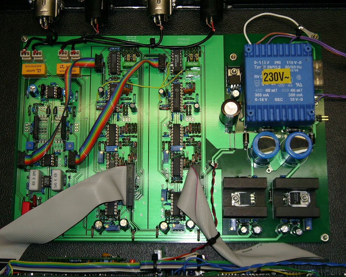

Hurray!!!! Got my first mixbus ssl ripoff working!!!!!!
« on: September 21, 2007, 01:35:30 AM »
Sneak and drool!!
I called it MIXBUZZ, but...s/n is -88 db @0db gain inp. level 0db (0=+4db)!!!!
Of courZZZ, sounds NICE!
 :grin:  :shock:  :cool:  :grin:  :grin:  :shock:  :cool:  :grin:  :grin:  :grin:  :grin:
More later!
http://www.ij-audio.com
(new site hopefully will be up in July)

Wow. Nice work. Nice and clean wiring.  :thumb:

Siemens PS on rail? Cool never seen blue ones in usa! Very nice! What boards are they? And try not to use the word "ripoff". Means steal in USA. Great job tho looks awesome! Congratulations! She is born!
Single channel? Only 2 xlr's not a "Buss" compressor...
And what is with the 48 conductor ribbons?

LED readout is awesome! I'm gonna use Analog on mine.
What the hell is it reallY? It's NOT a BUSS Compressor looks more like a computer upgrde from years past.

Quote from: "Stagefright13"
The other two neutriks are black ...you can see them if you look close

Well I will never buy a DBX product with a 48 pin ribbon.

This is not 48, but 26 pin ribbon and only control signals run there.
I'd bet my hand if I used it on audio!
More pics:
The whole idea was to make compressor which can be dual mono but all controll comes to leftside by just pressing a button, and 2 options of link: original SSL and Gyraf.
Last sounds IMHO not very good compared to link-after-detector.
Used dg403's and dg409's for controll link commutation, and did not liked them.
About 20 Ohm ON resistance??? Relays cheaper. ON resistance
few milliohms. DG's are Crap. Anyway, used relays for bypass.
Next will be throughotly relays for both audio/controll.

That looks BETTER than store bought! Where did ya get those TO-220 heat sinks? they look cool never seen them before...
At first I thought it was a DBX compressor. That's why my stupid comments! Sorry about that. Take it as a compliment!

TO-220 heatsinks are from Aron's Surplus Store, the best place
in Israel except maybe Sho'ham Surplus Store,
$10 for 30 heatsinks. Enuff for me.

it looks really great!!!     :thumb:
what type of pots for threshold and makeup are you using?
you have an auto-setting for attack time...  how's that done ??
