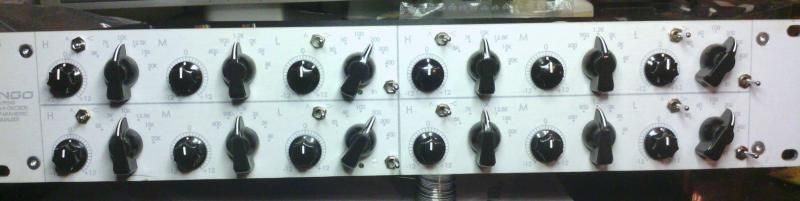

hello!
this is a new gyrators equalizer, it has been designed by PPA(Pierpaolo) for500rack
He has sent me 4 prototype pcb 's and  I have assembled them with his schematic.
It uses old and modern inedit discrete  topology using doa's
the gyrators use germanium transistor
it sound great! i like it so much.
This eq has a vintage sound -mids, basses are very good but high are fantastic
it has the particularity to not change the features of the sound at max boost/cut as an eq should do.
Moreover, with max gain you don 't keep noise or garbage,very quiet gear
I don't know if Pier Paolo has intention to put it inthe diy market, you shoud ask him!! ;)
dingo.
here with his big brother..
dogma
looks stunning.    Pier is such an amazing designer the world should know about him.....

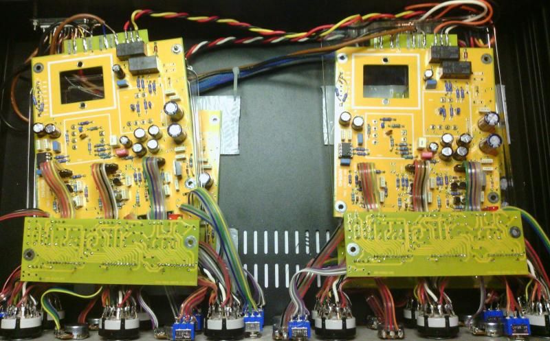

Hi Pier,
thanks for APP992´s.
Hope, that my solder joints are OK... I'll see (hear) in a few weeks :-)

Vac11, if i'm not mistaken, you have mounted the DOA's upside down. They should be mounted atypical of other DOA mountings (i.e. PCB traces facing upward).

You´re right druu,all are upside down ::)
Look here:

Hi All,
the first version APP992 was  upside down, instead the actual version (from a few of years ago) is normal as Vac11 did.

That will make Vac 11 a happy guy ;D
I hope the build hasn´t changed technically?
