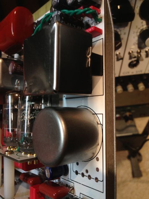

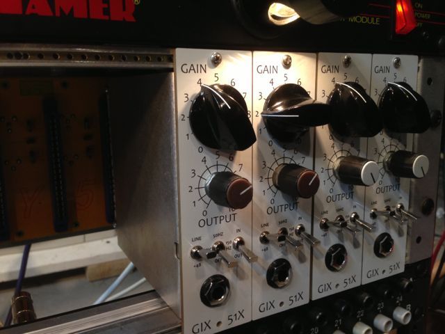

I had a slight detour to build a test signal driver that could drive RightMark tests through these both in Mic and Line mode, but I now have four units in test.
2 with Lundahl input and output
1 with OEP input and Output
1 with Cinemag Input and OEP output
Here are the 4 racked up for testing (Show and tell)
I wanted to verify my ears for the additional HT PSU filtering I thought was necessary, and I was able to measure a 8dB improvement in RMS noise measured with the additional filtering.
In most of my testing I found that the little Metal Shields I built for the power supplies make no detectable difference (they ranged from 0.6dB better to 0.2dB worse!) or at least not a difference that was repeatable in my test environment.  That was until I tried the Cinemag input transformer.
As you can see from this picture, the Cinemag sits closer to the power supply than the other transformers.  When testing with the Cinemag (using RightMark RMAA through a USB sound interface and my test interface) I see 3dB lower noise on with the shield in place.  But I can ONLY measure this on the Cinemag (I think because it so close to the HT power supply).
Other testing conforms to what folks see on the Gyraf G9. I was seeing a pretty substantial low end rolloff on all the units until I tried one with an old Altec input transformer, and then I got a Cinemag input transformer and again it had less rolloff (at 20Hz I was seeing it down 10db, with the OEP and Lundahl input transformers,  with the Cinemag it is about 3dB down).
Sure enough if I drive the test interface through the Guitar/DI input on the front I don't get the big rolloff either, so I am pretty sure the input transformers are involved.
There are posts about this on the Gyraf board, and my measurements match the ones there pretty close, but they speak of different OUTPUT transformers.  What I am seeing is that the input transformer can effect the low end (I assume because in Line mode the input transformer is still in the path).
I also see a bit of a high end response peak on the OEP.
In any case Jacob warns on the G9 board that it is important to test with your ears, so I think it is time I get these into use and hear what they can do.  They test out quiet enough.

bruce0
Re: [BUILD] GIX-51X tube preamp
« Reply #156 on: April 20, 2013, 09:34:04 PM »
I just have a thin folded MuMetal shield, but I think the field is Magnetic, and really any Steel sheet would do it, like a cut up tin can.  I can try that if you like.  I think you want something that is permeable.
I am just using mumetal foil (cuts with scissors, very thin) much thinner than a tin can.
As I said, no measureable effect except for the Cinemag... and I think that is because of the position.  Perhaps it is possible to order triple shields on the Cinemag... you can on Jensens... That would surely eliminate any issue.
I just don't get the rolloff differences related to the input trafo though.   I think the OEP needs a zobel too. Want me to post some measured sweeps?
Currently I have 3 flavors, all of them are quiet.  Here they are, and my test gear in the background.
Lundahl In - Lundahl Out
OEP in OEP out
Cinemag In, OEP Out

You my find the noise comes from the orientation of the Cinemag transformer rather than the proximity
Subject to change with out notice
bruce0
« Reply #158 on: April 20, 2013, 10:16:05 PM »
I can't hear the noise.  It is -88.7db noise level vs -85.6 noise level (this test gear does not measure below -96dB or so, so the absolute numbers should be ignored, but the relative numbers show it is a minor issue.)   If it was loud a human can't hear less than a 3dB difference, at -80 plus db... it is way in the noise.
The orientation of the trafo is tough.  The circuit board has a place for pin 1... and there you go.
