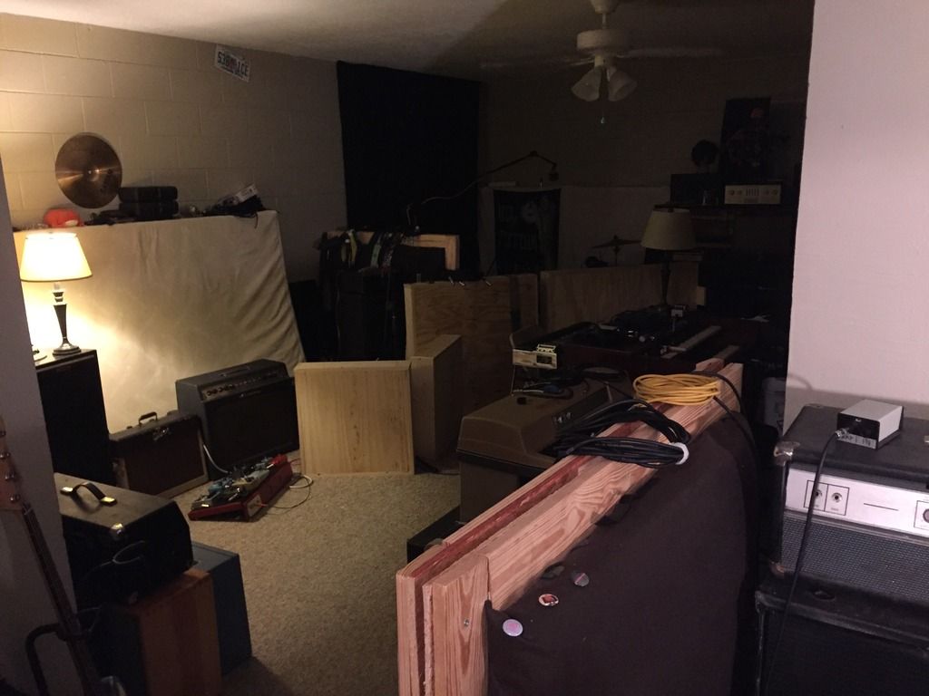

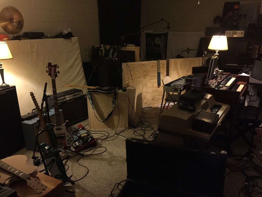

I should add some new recordings, but I have found several things I was doing that I adjusted for better results...
Guitar sound - I think it was the room.  This is a bit aggravating, and I wish I knew how to learn the why of this, but here it goes:
The room is a rectangle, with a smaller corner offset, so it is essentially an "L" shape.  the rough dimensions are something like 20 feet by 16 feet, and then the leg of the L room is probably 12 feet by 6 feet ceiling is 10 feet.
I have multiple baffles and many instruments throughout the room, and it is "Treated" with a large heavy foam mattress against one of the brick walls, along with the baffles throughout the room.

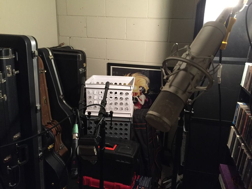

The best place in the room for having enough area to set up mic stands, etc ends up being roughly in the middle of the larger room.  No matter where I place baffles or direction I turn, acoustic guitars sound boomy.  If I go into the "L" part, it sounds awesome.  Every mic, a variety of positions.  Never boomy, but, this space is very small.  I could not fit two acoustic guitarist singing and playing live together over here...
That portion of the room has a large Vinyl LP storage shelf (6 feet tall, 3 feet wide) in the corner, a CD/DVD rack, about 10 guitar cases, and a couple tool boxes.  I set up directly in front of my 2x15 bass cab, with a baffle behind the chair.

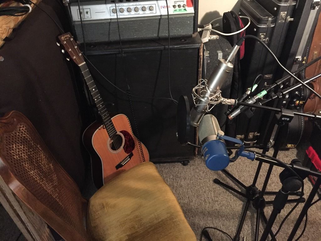

Vocals - I'll try the pencil trick.  I got the UAD de-esser.  I already place the mic off axis.  Some of it is maybe over zealousness...
I've been putting the mic in figure 8 about a foot away.  You can see in the picture there some experimenting - I liked the results of the ribbon + LDC.

For the electric guitar try to stand the amp up until it has the full room to blow and get an open space. Place it with the back as close to the wall as possible.
If your room is too boomy in general,
cut 1 of the mattress in to 1x1,5 meter and glue a 1-2mm steel plate on it. mount it on the wall in a way that it can freely vibrate.
You would need at least 3 paneles like this. Don't mount it in your drum area if you like the boom there.
The recording is not too far off. Feel free to post more audio. :)
rockinrob86
Re: Possible Sibilance issue, tips appreciated...
« Reply #12 on: March 25, 2016, 02:31:23 PM »
electric guitar I have no issues, and tracking live Bass and drums sound great.   Problem is just acoustic guitar related
Which I think is relating to the DB levels in the room - At higher levels my room works well, but the lower levels of the Acoustic guitar result in the boomy thing
Although, I never really use any distance mics on electric guitars, usually just a beyer M69 on the cone and maybe a ribbon 2 feet away or so...
The mattress annihilates flutter echoes I was having, and also greatly reduces electric guitar problems with the back wall.  It used to HURT to be in the room even with a small guitar amp!  I think the room is stuffed full of so much stuff (wurlitzer, hammond, my wooden baffles) that it breaks up most standing waves.  It is pretty awesome how loud you can turn up the bass amp and how little bleed I get into drum mics!
