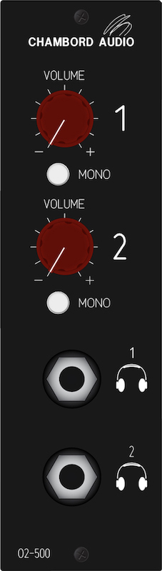

Hi Guys,
I built many variant of the Objective2 Headphone amp in the past year and was always pleased with the results.
This time I went for a 500 series module with 2 independent O2 amps.
The circuit is identical to the original from NwAvGuy, including the power protection. I added a balanced input using a That 1286 IC.
I'm ordering PCBs and panels this week. I might sell the extras if there's enough interest.

Hi Gabriel,
Interesting project!
-Since the API500 format usually handles only 1ch of audio per slot, how has stereo I/O been implemented?
-Are the two Phones jacks carrying the same stereo input signal?
Many thanks,
Best regards,
Rogy
Hi Rogy,
Module's XLR input = Left Channel
Module's XLR output = Right Channel
Yes there's only 1 stereo input. But they are 2 independent amps.
Meaning you can have a pair of 32 ohm cans plugged into the first amp, a pair of 300 ohm cans in the second amp and both users have plenty of power + proper volume control.
