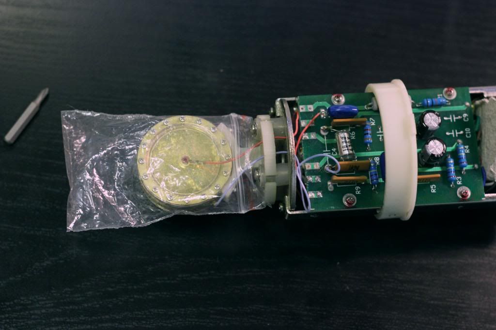

I've had this T-bone sct2000 for a very lond time now and i have been using it on many records.
Though i liked its sound i wanted to see if i could improve or somehow make it sound less harsh.
I was in touch with Dave Thomas and i ordered from him his RK47 capsule, BV8 Transformer and 6072a tube.
I've been upgrading the circuit like followed around and i thought it would be good to put this here with some sound samples so that someone else could attempt this.
It costed about 150 euros to mod.

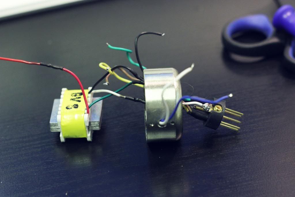

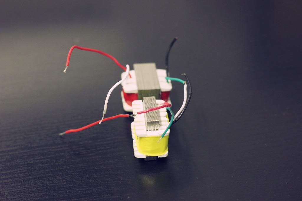

Here is the BV8 (in Yellow) next to the stock transformer... Almost twice smaller and somehow the stock one seemed pretty decent built quality.

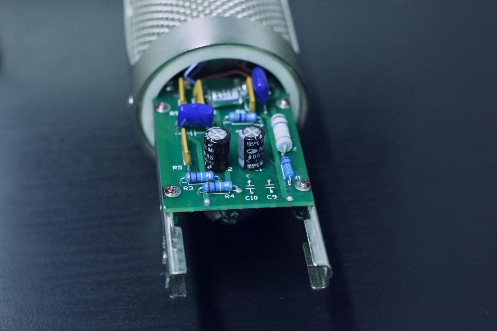

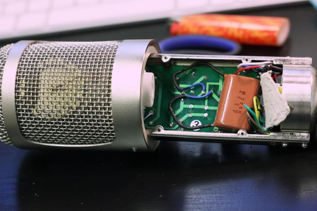

Here is the circuit where i removed C6, C7, C9 and C10 from the circuit.

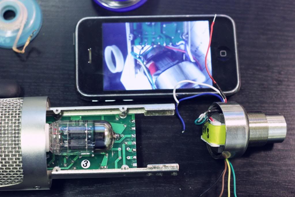

Putting the transformer together was pretty hard with my small knowledge in dealing with small cables
Best way to remember how to solder everything back
The BV8 is too tall to fit in the Bell housing so i decided to remove the top part and for now will keep in place however i can. whenever i feel like this is the right circuit i will hotglue it.
C8 was updated with a more Audio-like Capacitor but the value changed from 1uF to 2,2uF
Change the Zener diode to get around 120V on the B+... I updated the zener D6 so that it would be around 121V at the output but i haven't checked it yet...

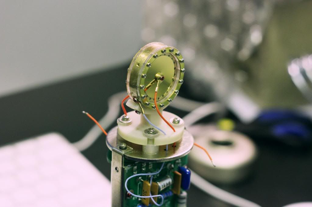

T-bone stock 34mm K67 style capsule...
The Final step. K47 style capsule 32mm in place. It fits on the stock Capsule holder.
That's it for the build, nothing really hard...
As for the sound, well it is another mic, better i don't know. i like it more that way.
It is much more flat and not so bright. Though with a touch of EQ it is perfect and for my voice gives more body to it...
I am big fan of the SM7 mic and i feel like this mod got the t-bone closer to it in a way. I like that. Though it is really nice on bright source like bouzouki or Female vocal. Very nice.
I have tried through a DMP3 so i could hear only how the mic reacts but i will hook it up to my Golden age PRe-73 and will post some sounds via soundcloud in the week-end. Some guitar and vocals and maybe a piano straight into mbox2 pro to hear that too.
Thank you Groupdiy for all the help and Dave Thomas for the kind words and parts
