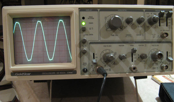

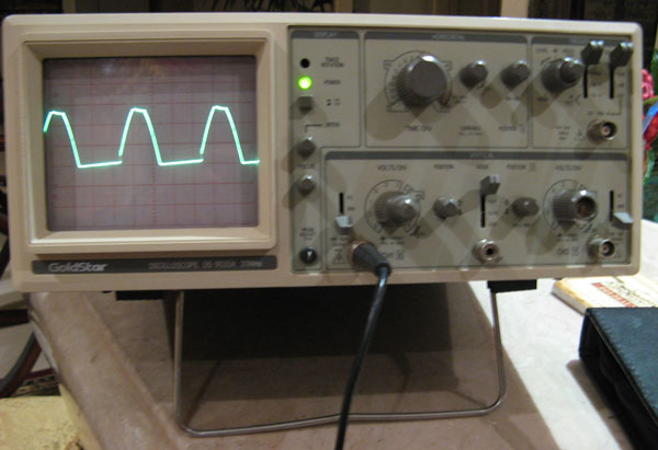

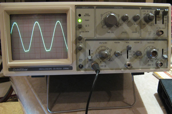

Calibration RV5 - Symetrical Clipping
##Note: Things to watch out for to ensure a trouble free calibration
  • Make sure to connect the signal generator to the EQN solidly
  • Use a preamp to get a signal high enough into the EQN
From my understanding of this process is that, you are trying to get a sine wave to distort inside the EQN. You are not to feed it a distorted sine wave but a sine wave that becomes distorted inside the EQN because it is being fed the signal too hot into the EQN.
The EQN requires a high sine wave signal in order for the sine wave to clip on the Oscilloscope in the RV5 callibration process.
This took me a while to get but I think what I have done is correct.  :)
I installed my EQN on it's own in my lunchbox on the far left, so that I can have access to the RV4 and RV5 trimpots
I used my Macbook Pro as the signal generator, using Logic software that can produce a 1Khz sine wave
I connected the Macbook Pro out to a Great River preamp to boost the signal
I connected the Great River preamp out to the input of the EQN through the lunchbox
I connected the probe of my Oscilloscope to Pin 2 of the EQN output through the lunchbox
I connected the ground cable of my probe to Pin 1 of the EQN output through the lunchbox
I set my EQN as follows: EQ in, ALL frequencies set to OFF, Gain knob to 0
I turned the RV4 Counterclockwise to as far as it can go, so that the output stage is fed the incoming signal in the EQN as high as possible to help cause the sine wave to clip on the Oscilloscope
In Logic, I set the sine wave level to Max(in the red)
The GR input leds shows red
I turned the output knob of the GR so that the output led of the GR is red
I ended up with this reading on my Oscilloscope, where the clipping is on the bottom
The problem with this, is that if I turn RV5, to try to get both clipping top and bottom, it actually makes the bottom clipping wider than the top. I have realised in order to get a symetrical clipping, I have to get my initial clipping to start at the top, and not the bottom. I have noticed that the bottom clipping increases at a larger rate than the top clipping hence, the funny shape sine I got.
In this situation, since the clipping was at the bottom. I turned RV5 counterclockwise, which slowly rounded the bottom clipping into a smooth sine again.
I decided to boost the signal by pressing the impedence button on my GR and then boosted the GR output knob more until this time, I got a top clipping.
I turned RV5 clockwise until the bottom of the sine wave started to clip and I stopped turning RV5 until I got a similar size bottom clipping to the top
I tested my EQN after using this method of calibration and so far so good. The unit sounds pretty good!!!
