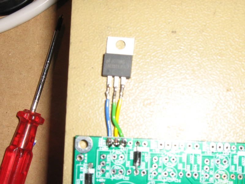

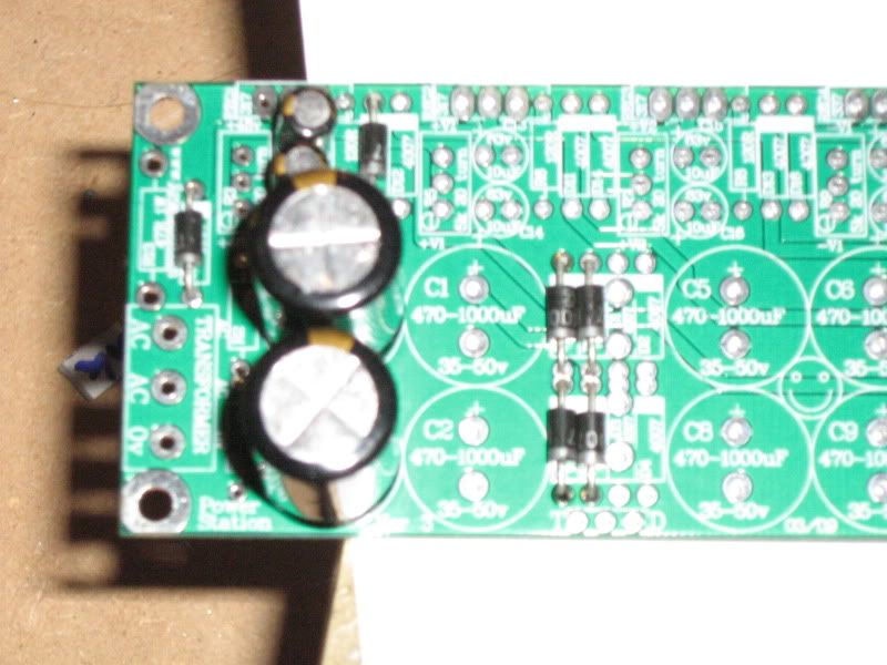

here's JLM negative doubler mod :
reverse the direction of the components shown. NOTE !!: C1 and C2 must be reversed as well !.
wire the 337 like this :
As said earlier : use a dual 15v torroid, and preferrably add the large diodebridge (not for the V1 version.) Set the +ve's to +18, -ve's to -18, and the negative doubler to -24v.

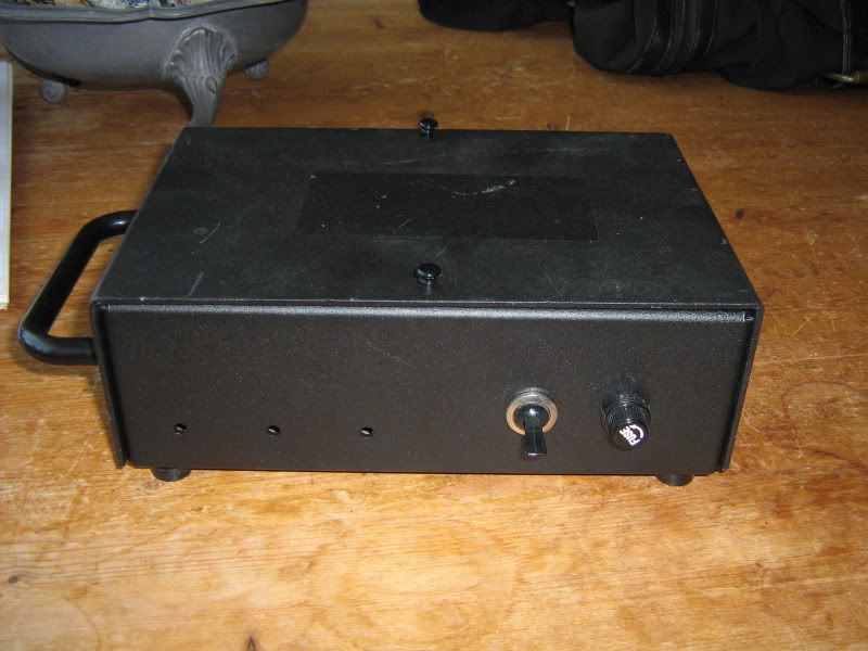

Here are a few pics of how I recently built a psu for a lunchbox I'll be building soon (summingbox+521+522 EQ+520 buscompressor). The PSU with the mod stays cool. I've built a similar PSU, but then without the mod, for a Neve channelstrip project, and that one gets pretty warm.
The enclosure is used, taken from a defective electric wheelchair battery charger.

At how many VAs should the transformer be rated (if 15-0-15) approximately to get the full current of the board (for two times +18 and -18Vs)?
If center tapped -is the bridge still set to doubler?Just because Joe told me I had to cut it when I did the "normal" mod to get a lower voltage from the 48V rail.
Oh,concerning heatsinking,Joe´s heatsink-Calculator is  a supertool-I always use it!:
