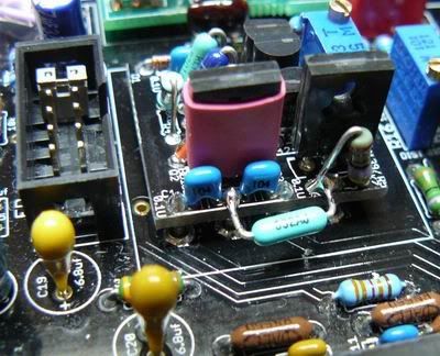

1). When running on +/-16V, in 500 format, install jumpers JP1, JP2
and cut pins 17/18 of card edge connector.
2). When running at +/-16 and +/-24V, !DO NOT! install these jumpers,
they can cause damage to power supply.

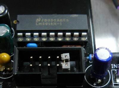

On FP (10 pin, dual raw) connector on motherboard,
short pins 9 and 10 to switch relays from BYPASS state to COMP IN.
(PC jumper will work fine).

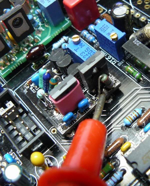

Install input/output amps. Check if current draw is less than 70mA each +/-16 and +/-24V.
If don't have lab power supply, measure voltage on R91, 92, 93, 94 resistors (10R),
it should be maximum 0.7V at any resistor.

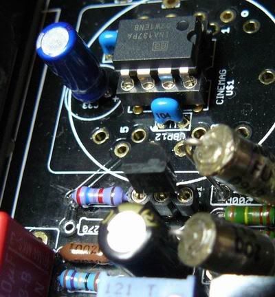

Input amp.
Close input and output pots, and, if my version of input opamp is used,
put DC voltmeter between amp's out and ground adjust amplifier's output
for +0.3...1V with trimpot located on amplifier's PCB.
Note 1: let amp heat up 5-10 min.
Note 2: to get VERY tasty sound from this amp, connect 1...2k, 1/4W resistor between its out and gnd.

Connect RATIO/ATTACK/RELEASE board (and remove jumper between pins 9 - 10).

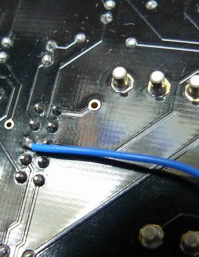

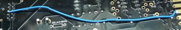

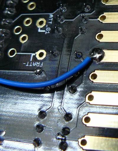

BTW, don't forget to connect wire at back side of PCB if use LINK.

Distortion cancellation circuit.
Adjust DIST (R16) to get minimum of distortion on sinus wave.
Or, misadjust a bit for color, but mind, too much will not sound good.
0.01....0.04% THD is fine.

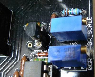

!AA
Remove input signal, put METER to GR, and adjust 0 with 0GR trimpot.
Yellow LED should light ON. Light ON the +1 RED LED, than, turn the pot back, just to leave yellow LED.
Repeat this step 1-2 times.

2.) The link wire for stereo on the bottom of the board, is that needed for the stereo link to work, or just for calibration purposes?
Rev.1.3 has this connection (trace) at PCB; at rev.1.4 I fixed some mech. issues, and this link has gone somehow.
To make a pair working in stereo link, you NEED this wire.

IMPORTANT
For use with input line receiver, DO NOT INSTALL R5' = 270R!!!!
For use with input IC amp, INSTALL R11' = 560k.
This resistor IS installed on "my" or "original" input amp PCB.
