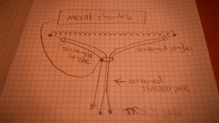

This is a Rhodes MKI;
So evey hump is a little coil actually and they are all in series and there's 73 of them.

Do microphones always tie one end of the capsule to ground ?
Does it make sense to creat a a differential input stage for ultra low noise performance ?
Would an input transformer be ideal in this case ?
Actually none. Mics are usually kept floating. Only teh body is connected to the cable shield.
It is debatable. If the preamp is close to the pickup, no. Didderential (balanced) connection cancels interference that is sensed by both wires; if they're kept short there is not much interference.
Differential is usually noisier than an equivalent unbalanced stage, by 3dB.
The problem is that teh pickup is relatively high impedance. You would need a transformer with a nominal impedance of about 50 kohm.
