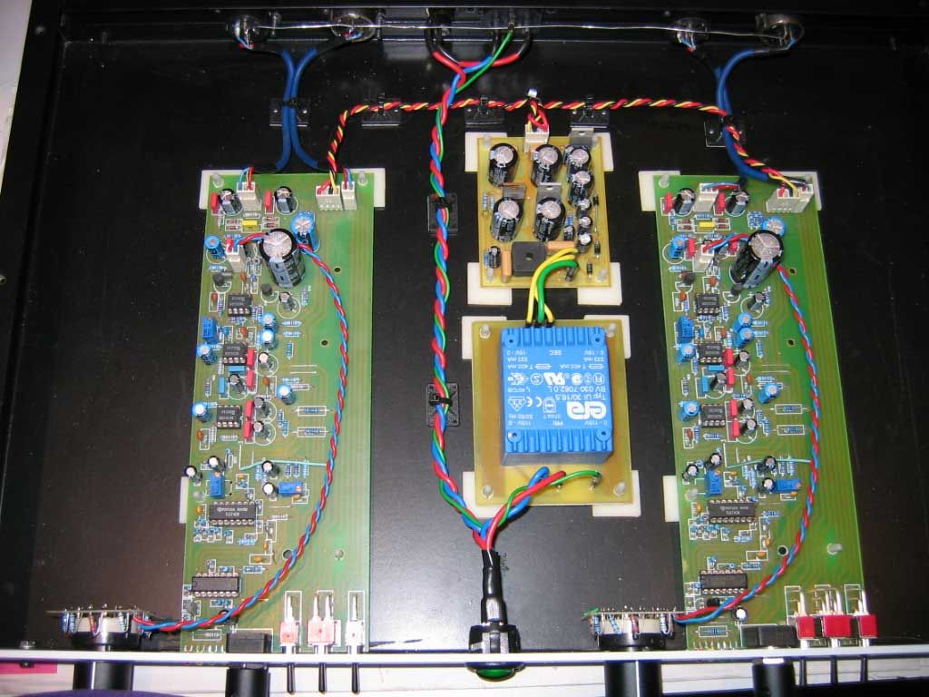

Matthew, don't star ground the AC side of the power supply board, just the DC side.   Where you see "AC AC Gnd" on the power supply board, nothing should connect there except the amveco. (please someone correct me if I'm wrong but that's how I've always done it.) You still have to star ground the ground terminal of the IEC power inlet and the DC side of the power supply board.

I think I can sum up my question with: what connects to the AC inlet ground pin?
From what I can tell, it would be:
a) Pin 1 of all XLR inputs and outputs
b) The chassis
However, when I look at this pic:
...it shows three wires going from the transformer to the AC inlet.
According to KingKai, there are just two connections from the xformer:
Pri: yellow and red to power "neutral"
black and violet to power "hot"
So I guess I'm just unsure of how "Ground" actually gets to the power supply, if it doesn't connect directly with the xformer first.
Does that make sense or should I try to explain it graphically?

The power inlet ground joined with the DC ground or 0V and then that was my Star Ground. I did it that way with my Green who's almost complete.
Hope it helps.
Hope it helps.
So, from the "output" side of the PSU (ie. going to the channels) there is one extra wire, which goes from GND to the power inlet ground?
So that GND terminal would have one connection for each channel PLUS a wire going to the AC inlet?
That looks to be a different scheme than the pic above, no?

It looks like my preamp...... It is my preamp...
I'll have to check it on MOnday, but it looks like I used the AC inlet as ground. I have actually changed this unit, swapped out the blue transformer for a toroidal unit. I dont think I changed anything further, but I cant recall.
So, in the pic, the star ground is at the AC inlet Gnd pin.
The bare wire buss connects the XLR pin 1's together.
The Green wire from the AC inlet Gnd pin goes to the PSU.
The input XLR Pin1 on both channels goes to the preamp bords via the shield on the blue cable.
I am not sure where the Gnd connects to the chassis, will check the unit.
This preamp is DEAD quiet.
Peter
Ah, but this is where things get confusing for me. It appears that it's not the PSU that connects to the AC inlet Gnd but the transformer, and the Amveco 62043 doesn't appear to have a separate Gnd input.

Ah, ok! I get that bit now. It looked like you hadn't connected that at all, so (it appeared that) the only Gnd that reached the boards was via the power supply. So, in that pic, between the XLR inputs and the channels you have a red wire, a light blue wire AND the shielding for that (which carries the Gnd), ALL within the darker blue insulation.

I've also been thinking more about the pic of Peter's preamp that you posted. The only explanation I can think of is the IEC ground is connected to the blue case as a shield and wouldn't apply with a regular toroid.
