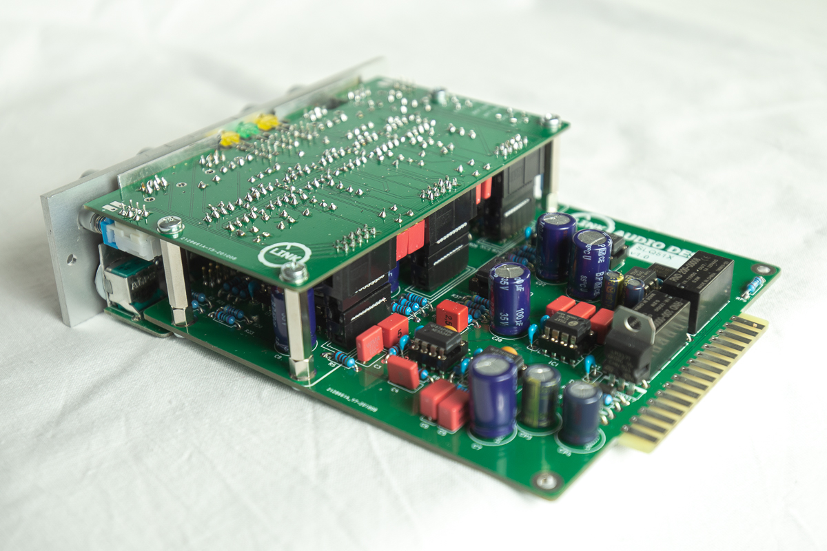

Since the last weeks i'm designing this loved SSL Styled EQ for 500/51X series
i used the shematic of the 4000 EQ with 1246 In- and 1646 Outputs.
In my Version I added switchable Low Cut and High Cut Filters
Biggest Problem as always small Potentiometers. but i found cool working pots
Its running on +16V/-16V in the VPR or 51X Rack

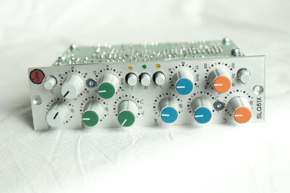

I finished my second prototype boards and and got a nice frontpanel from Frank, final version will be black powder coated so i can offer kits in November, so christmas is saved for DIY. Also the Knob Caps for High Frequency will be RED. At same time I working on a white Market Thread.

Were you able to get small enough knobs? I did a version of the 4k but found the front panel a bit too cramped with the smallest sized knobs that were available, think the commercial version is a custom mold. The PCB layout gets rather tight too with through hole. Just some things to keep in mind.
It's a great project, and a great mixing EQ.
Yes the commercial one has also just 11mm knobs,
i use sifam 11mm knobs for this project. but i have two pcbs top on top and place parts between these two pcbs. than it gets a bit easier to place that many parts.

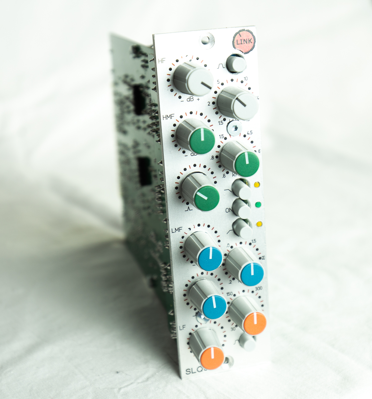

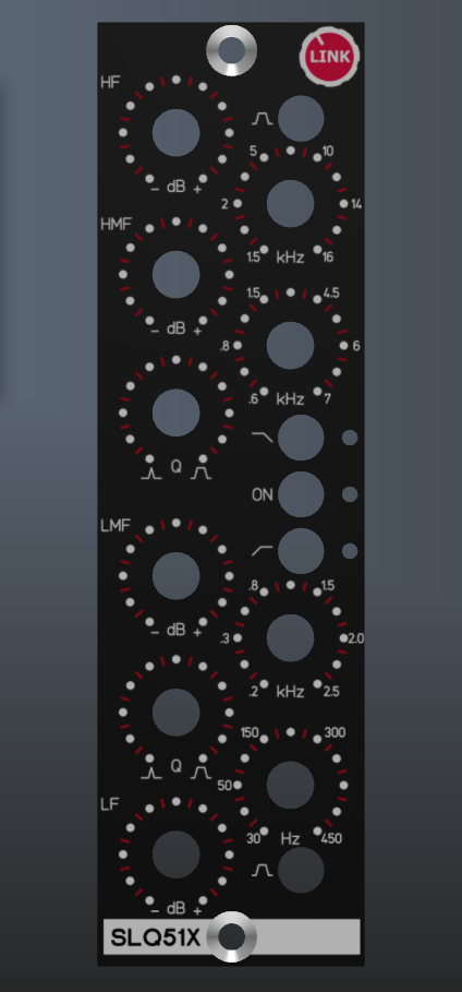

How are the controls for the hp/lp implemented? I see the holes in the middle of the panel, but are those for pots or toggle switches? Is the cutoff variably controlled with a pot, or are toggle switches switching in a hp/lp with pre-set cut-off frequency? If using pots, where are the graphics for the cutoff frequencies?
I do understand if they are toggled because of limited frontpanel real-estate...
Yes the hp/lp are just toggle Switches, but with indicator LED, i use fixed frequencies for that. 80Hz and 12kHz Cutoff. its a 3 Staged circuit like you already know from the 9k/4k by Bruno Preamp. It's a 3rd order Sallen Key Filter. In fact you still have shelf filters for low and high and reduce with them frequency wise the cut or boost. And in fact 10 pots are the maximum you can squeeze on a 500 panel. if you put the 11th Pot there you can't put maybe just one other toggle switche there. ;)

Maybe going for a more SSL 4000 color look ?
And HF knobs maybe red too ? Like the real thing ? :)
