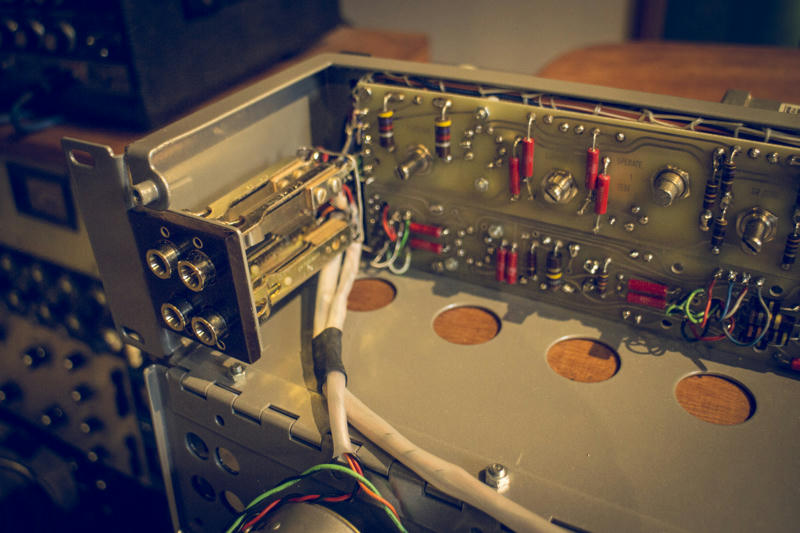

Here is the original 1964 silver blue metallic paint.
Really gives the unit the right vintage vibe! Very cool color. It looks gray in pics. But In light you see the
blue!
Pics against my real unit. Then outside light picture in next post.
All screws are #4-40 pan head small drive nuts. #6-32 with small drive nuts. Haven't measured the Transformer bolts yet. Next size up and the largest.
All screws are single slotted pan heads.
John

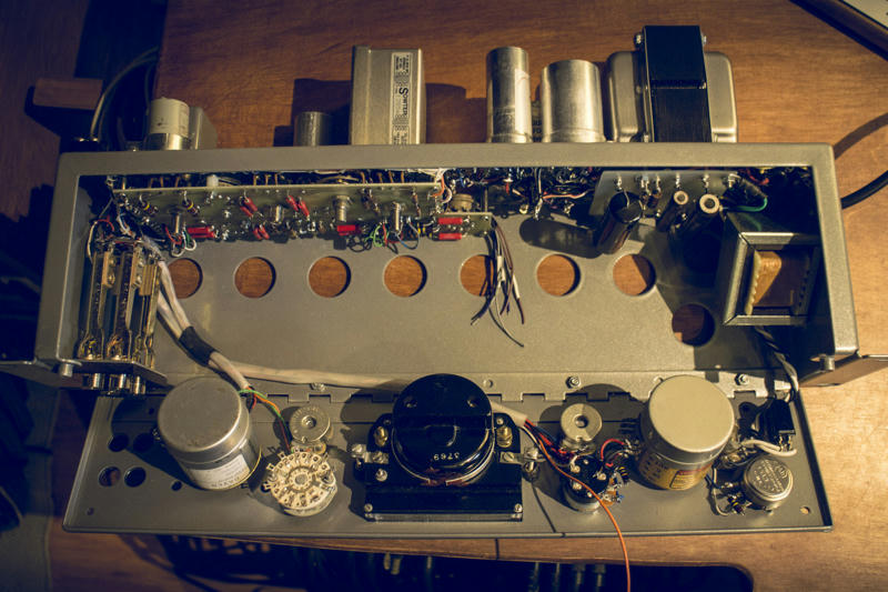

Here is the real color in the light. Gray primer then silver blue metallic.
After I ream the large 20uf x 4 Hole. Then knock out side studs and door studs for #4-40
screw and nuts. Then paint the chassis.
John
