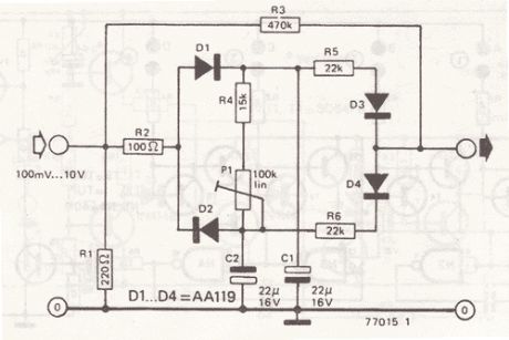

Hi Guys.
I have been using a homebuilt headphone amplifier for drumming gigs for about 5 years now.
I need to build/ design a fast limiter for those incidents when the sound guy does something stupid and blows my in-ear-monitors.
Anyone built something like this willing to share their work?
So it should do "nothing" normally?
But should limit when HUGE signal hits the head/ear-phones?
And you don't care what the limiting-action sounds like? You just want to avoid damage?
And you don't really need "fast", relative to typical sound-squashers. 0.01 seconds of transmitter over-modulation is ugly all over town. Headphones can take huge power for a second, it takes several seconds for "loud" signals to burn them out.
I'm thinking what you might really want is a cut-out. 3 Volts for 1 Second, a relay drops-out, headphones disconnected. Probably a timer so that 2 seconds of not-huge signal lets the relay pick-up again. A fairly complicated thing to design, build, and calibrate.
Yes. For years I protected some costly (to buy and also to get off the ceiling) speakers with a few passive parts wrapped around the power amplifier. Below threshold it does "nothing". Above threshold it applies a quasi-RMS limiting with uncertain (depends on the LDR) time-constant. Sound gets a bit squishy mucky, and you don't want to work the system above limiting, which in this case was the idea. (I also had a "nice" limiter before this to take peaks off; this kludge was the back-up for idiot operators or gross accidents.)
Here's the simple form. Assumes headphone amp can stand an LED across its output (it really should, if it can drive low-Z phones).
LED across driver shines on LDR which works against resistor at amp input.
Any generic LDR will be fast enough to protect drivers. Release time is uncertain, but likely fast working against 5K-10K resistor (too fast for "nice" limiting, but you don't need/want "nice").
LDR resistance should come below a few K Ohms when you hold the LDR against a bright LED.
Limiting is 1.6V peak. This may be ample for the more sensitive in-ear monitoring plugs. If it won't go loud enough, try two LEDs in series for 3.2V peak. The extra LED may be mounted on the panel so you know when it's working.
Deluxe variations include back-to-back LEDs so both sides of the waveform are covered, or a FWB before the LED(s) for the same reason (but adds 1.2V of threshold), or a 100 Ohm pot so the limit level may be dialed-up well above 1.6V (I used that when working 75W speakers off 300W amps).
