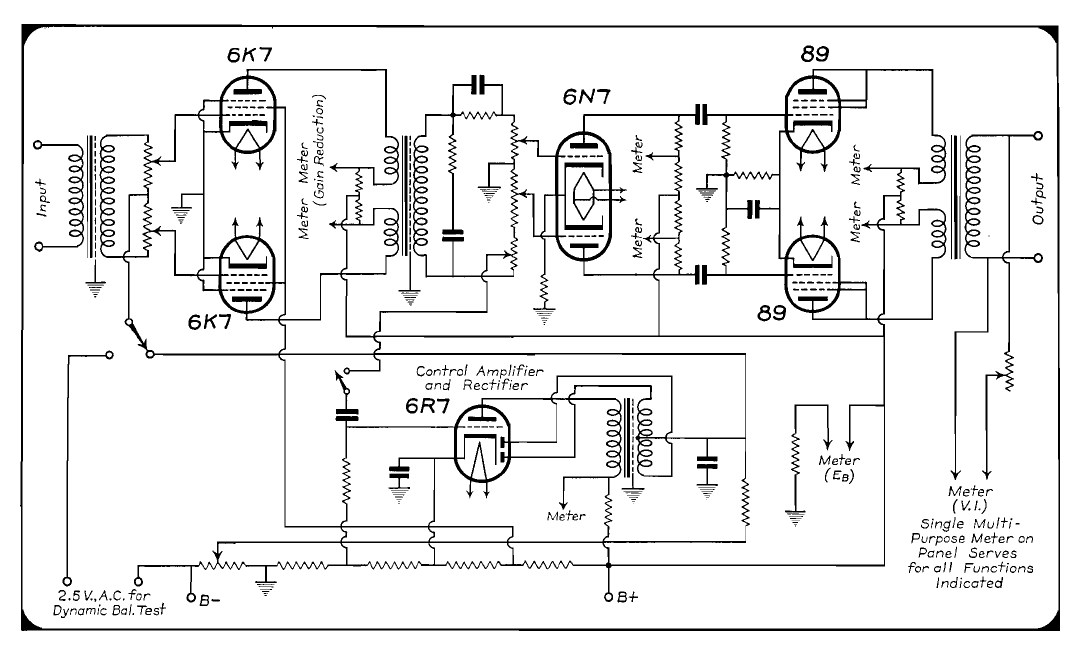

I have a few months before bookings start in ernest, so I am going to tackle this beautiful work of art from the 1930's.
Together with my friend Ian Barter,  we have been exploring vintage sounding equipment, the OP-6 was the last project in this vein .
The balancing update from the 86B has been incorporated  but the rest of the audio path will be just as it was 83 years ago.
Obviously, chrome plated transformers are no longer available, but I will be using  similar transformers to those I used in the OP-6 with good results.  Here it is:-
This is the basic circuit:-
I have added modern attack, release and threshold controls to the circuit with a modified side-chain.

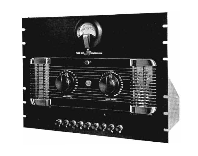

Here is the first of many!
I started to cut metal today, this is the faceplate cut to size, but lots more to do on this, as you  will see.
Soundcloud: Delayed Action.
Re: RCA 96-A from scratch
« Reply #14 on: February 16, 2020, 01:47:27 PM »
Are you going for semi-accurate look on this one?  Surprised to see 8RU.
« Reply #15 on: February 16, 2020, 03:25:58 PM »
As accurate as I can make the front anyway.  I did not take the project seriously, until I had worked out how to do that.  It will look quite spectacular in black and chrome.  I would have made it full size but 11.75" is the widest sheet I can sensibly source.  It will not have the same round VU meter (never seen one for sale) but it will have a vintage 4.5" meter, they always look good.

do you have the complete schematic with values and voltages as well? i cant find this info..
i f i understand it right, rca made the only comp/lim with varying screen voltage instead of varying grid voltage for controlling the gm.
is this right?
wonder how it differs in sound compare to every other vary mu comp?
how much does the screen voltage vary? im guessing 100v when not compressing and down half to zero voltage when compressing...
My guess is they are the same as the 86A,
i f i understand it right, rca made the only comp/lim with varying screen voltage instead of varying grid voltage for controlling the gm.  is this right?
   I've not heard of this but Doug might know.  You may be confusing this with the use of 6L7 tubes on several early compressors, these used extra grids.
  The screen voltage does not vary because so much current is passing down the voltage divider.  The plate voltage does of course.

Ok im prob seeing this the wrong way but it looks like the sidechain signal gets rectified and mixed with the screen voltage via resistor net.
The grid is just fixed bias instead of being used as the control input.
Oh yes the 86-a is more complete.
« Reply #19 on: February 19, 2020, 03:58:52 AM »
There is a big pot divider that provides various dc voltages. One is for the screen and another is for the bias to the side chain.
Gain reduction is achieved by changing the grid bias on the first two tubes only.
