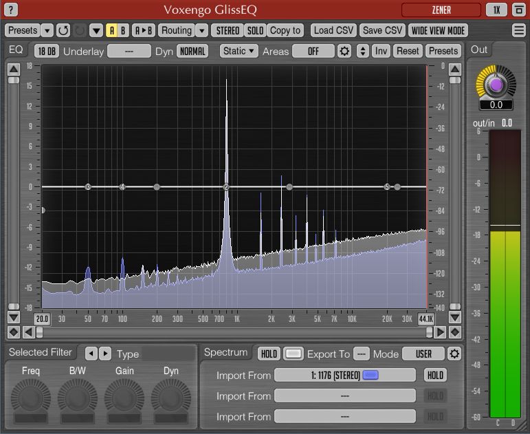

At which level do you run your test tone in dBu or volts peak-to-peak? Maybe the level is too low...? At healthy levels of >0dBu with the input fully CW you should be getting lots of distortion.
Hi fripholm, Thanks for the response....
I believe I was, but ended up going another route (using my DAW in conjunction with software scope) when checking which provided more clarity. Seems my build is complete now - at least as far as I can tell.

1.) When I put my unit into THD mode, there's a noticeable jump in output volume when switched from comp or limit mode - even with minimal comp or limiting. Is this normal behavior or something that would point to mis-calibration or other issue not understood on my end?
