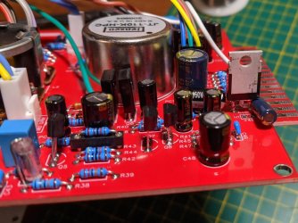

Hey Blackart, I've built a few of these now (the first version of the H9M, with buffer and no output transformer) - they're GREAT preamps, really top class, and I'm sure you'll be happy with them. There are a couple of things you'll want to know relating to the version I built, which might or might not apply to the PCB version you've ordered. None of this reflects on Matt's design, I ordered the boards immediately knowing it was a V1 and there may be some prototyping needed and Matt was really supportive in helping me pull things together.
Voltages: I couldn't get the H9M version to run happily off +/-16V. The various sections of the circuit all have coupling caps between, so in the end I replaced the diode on the -16V rail with a KA7908 regulator (plus caps from the datasheet) to bring the negative rail down to -8V (24V rail to rail). That did the job! The pinout of the KA7908 meant some very careful lead-bending and cap-soldering was required, so it might make more sense to substitute the diode on the +16V rail for a positive 8V regulator instead. I didn't need a heatsink, as there's not a whole load of current drawn.
Rotary switch: on the PCB version I built, the low frequency EQ rotary switch was slightly out of line with the other switches, around 1mm or so forward of the PCB edge. Easily compensated with a small cavity on the back of the front panel / bracket.
Phantom power: I ran an LED off the +48V switch - which meant that the reservoir cap didn't fully discharge when phantom was turned off, and phantom discharged very slowly indeed. The original might not have that issue as designed! Anyway, I used the info in this thread to address it.
Pots and toggle switches: there's a lot going on with a Helios front panel, so I ended up using Alpha 9mm pots and the smallest ultraminiature toggle switches I could find to fit everything in there. I'm sure that's due in part to my front panel layout and knob choice though!
Hope this all helps. As I say, much of this may be particular to the V1.0 boards I was working with. Either way, it's well worth it - they're fantastic units and I see them becoming my studio workhorses. Huge thanks to Matt for his generosity in sharing these designs!

I updated the later ones to include the regulator, as I also couldn’t get them stable at +/-16.

Excellent module, love the front panel layout. be warned transistor TR5 could do with a 4K7 in the base lead. In the past have found under certain output fault conditions the transistor fails and passes that onto the output transistors causing those to fail.
